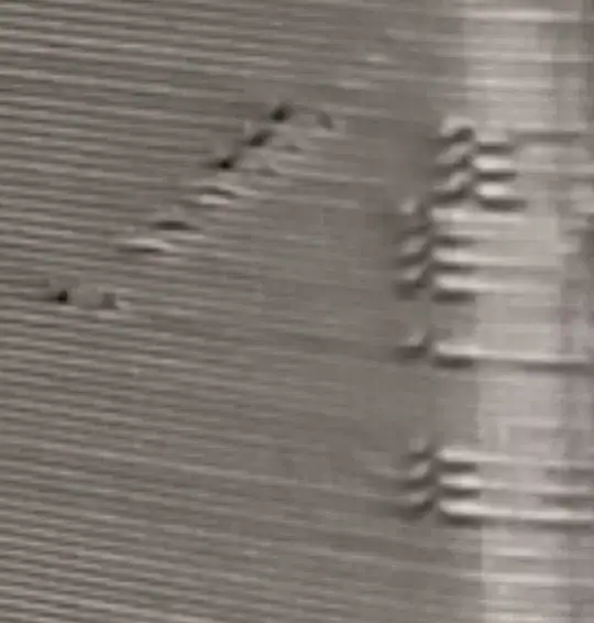

I am noticing strange print patterns ever since I upgraded to the Prusa multi material print head. The patterns are consistent printing upwards but inconsistent amongst each face.
I am using original Prusa PLA filament, and have tried to different extruder temperature settings (200C, 205C, 210C, and 215C) but they all have similar patterns. A different color and roll of Prusa filament is doing the same thing.
Any ideas or suggestions as to what to check next? Thanks for any input!

It is always very difficult to debug a printer remotely, but here's my best shot. I may be totally wrong though!
Zooming-in your picture seems to show like little bumps (inwards or outwards) that offset the extrusion in the XY plane.
zoomed-in picture
The fact the bumps occur on both the X and Y axis, and both inwards and outwards, and that the patterns are not fully regular make me think the problem could be as simple as the new printing head having some play, and some combination of forces waking bumping it momentarily off its intended position.
Check for play.
Play which is due to a static feature (like a loose bolt, a clamp not holding firmly enugh or a cracked heat break) can be usually be detected with the printer switched off, by holding the nozzle between your fingers and shacking it gently.
Play that is dynamic in nature (for example a roller with an irregular diameter or screwed parts becoming loose only when hot) can be more tricky to detect. The procedure is the same, but tou may have to heat the extruder (and use gloves, doh!) or to repeat it at different positions on the X and Y axis.
