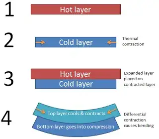

Simplifying things a fair bit, you can visualise the process like this:
  1. hot, expanded plastic gets deposited on cooler, shrunk layers,
  2. when the hot plastic cools down, it shrinks and pulls the upper part of the layer below inwards
  3. at this point, the layer below has a differential in the compression between its upper and lower parts, and curls up
  4. the problem is exacerbated at the very first layer (the one touching the bed) as this is "locked" to a rigid body (the bed) and cannot shrink, while subsequent layers are only attached to the somewhat flexible plastic beneath, and thus can contract.
diagram of curling plastic

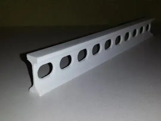

  • Make relief holes above the first layers in long structures. This will essentially "break" the build-up of tension in the layer, creating many points with a little "curling up force" rather than two with a huge one. Something along the lines of this, for example:
I beam with relief holes

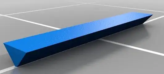

  • Avoid extensive overhangs close to the bottom of the print (this is because otherwise you will have considerably more material "pulling up" than you will have "anchoring down". Here is an example of what not to do (to be fair: this was specifically taken from a bed adhesion/warping test).
