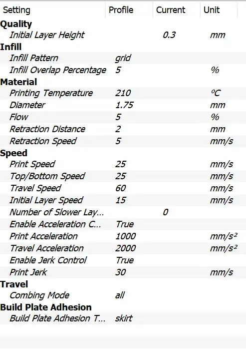

Here is the print profile: Screenshot of Print Profile

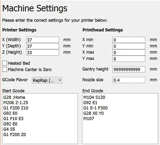

Here are the Machine settings:
Screenshot of Machine settings

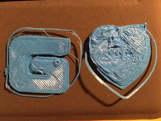

This is a photo of two failed prints. On the left is a G and on the right is a heart. Photo of two failed prints

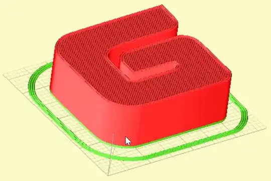

This is what it was the G was meant to look like:
Pronterface G

  • 210 is a bit much for pla, i suggest going for 185 or 195. Do you have a picture of the result you get? You say its under extruding but with a picture we can determine better if it is or not. – Granny Dec 19 '17 at 08:04

  • At first glance (line 527) values seems reasonable (if, as your sceencap states, your printable area is 37mm wide etc.). Is the printed item, roughly,correctly sized? If so, remove the bowden tube and make your controller software move, say, 100mm of filament through the extruder (mark before & after + measure), how much is it off ? -> correct line 527 (fourth value) + compile + flash ->redo testing until ok. EDIT: as eeprom seems disabled, maybe you are not overriding values with the 5% feedrate? Please tell. – Valmond Dec 19 '17 at 15:47
  • @Valmond So, it seems to be printing at the correct size. I have also previously calibrated the extruder motor's steps per mm. I don't get how I can check if the the 5% flowrate is overriding values or not. What values is it meant to override? – Joe Clinton Dec 19 '17 at 16:10

  • As i can see from your images and your additional info, you suffer from multiple issues. It looks like your printing way too fast (reduce acceleration and jerk for all motors). As other guys mentioned: check that your motors don't skip steps. Maybe your Z-height is not well calibrated too. – Kai Bepperling Dec 20 '17 at 10:38

One thing that I would advise is that you reduce the jerk and acceleration values, since they look to be far too high.

  • Look at the image posted, the motors are obviously skipping. His problem is not skipping though (in this post), but the extruder motor extruding too fast. – Valmond Dec 19 '17 at 13:33
I guess that either you have the hotend too far away from the first layer (so looks like underextrusion), then wrong layer height / wrong z-configuration so the layers are too small, making plastic pile up (seems like over extrusion). Eventually if the Z-Driver skips steps, it could look the same (printer trying to print the same layer several times).
There is also some skipping in the drivers, as your layers are not correctly on top of each other, check if you can 'up' the amperage in the drivers, or slow everything down (speed, acceleration & jerk) til it works without skipping.
