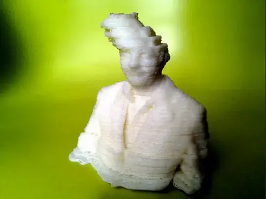

Shifted layer 2
(source: all3dp.com)
Your printer is skipping steps in the y-direction. This can have several causes. Take a look into Shifted layer guide on RapRap.org which lists 29 possible problems that can cause this issue and how to fix them.
First items of the list:
  1. Driver current is too low
  2. Driver current is too high
  3. Belt too Loose
  4. Belt too Tight
  5. Loose Set Screw/Grub Screw
  6. Belt or Bearing is binding
  7. Speeds are too high
  8. Acceleration is too high
  9. ...
When I was dealing with this issue on my RepRap I had to increase current to the particular driver.

  • Something else that I have also run into that can cause skipping is the filament not spooling smoothly. – EGHM Feb 04 '16 at 21:03
  • worn out/low quality linear bearings and rods they slide on can contribute to 4, 7 and 8. – Leo Ervin Feb 06 '16 at 00:06
  • I had the same problem on my Mendel, and it turned out that speed and acceleration were too high. But as @amra said, there are a lot of thiings that can cause this problem. – TextGeek Feb 12 '16 at 22:50
