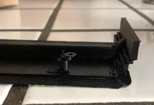

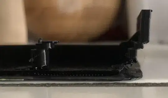

I have a weird problem, my object base starts good and then as the object goes to the next layers it is off centered. I have a picture to better explain.

4Layer shift is the keyword you should use to find existing info on this kind of problem. – R.. GitHub STOP HELPING ICE Aug 04 '19 at 22:25
1This is classic layer shift. There are lots of possible causes, but I would check for over-tight belts first. – Mick Aug 05 '19 at 03:55
