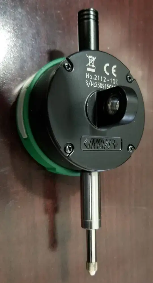

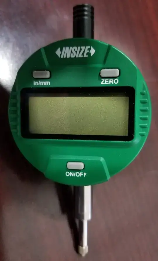

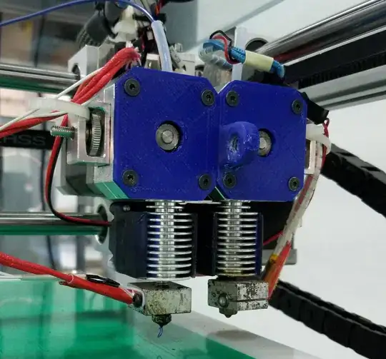

2) Second one is just more advanced version of the above. You use a dial indicator/ micrometer attached to your extruder and make sure the number on the dial is as close as possible on all edges.
Level the Print Bed on a RepRap / RepStrap 3D Printer with a Mitutoyo Dial Test Indicator
There are also digital versions of this tool.

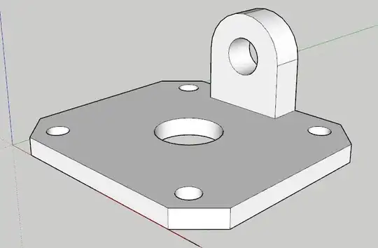

You might need to print or make some other way a piece to be able to attach a micrometer to the extruder (there might be one for your 3D printer on Thingiverse already).
