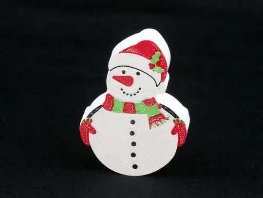

Take a look at this thingiverse snowman.
colorful Snowman
Each of the colors is a separate model. Each of the colors is only one layer thick (0.200 mm). Each of the colors is placed with zero overlap to the adjacent colors, as the extrusion multiplier will allow enough "squish" to cause a bond to its neighbor.

I've created at least one of the snowman pictured and it came out quite good. The layman will not be as astonished as someone familiar with 3D modeling and printing, however. You get a better appreciation when you know what goes into the project to get this result.
