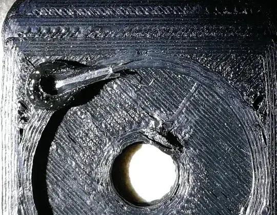

My best guess based on the answers and comments so far is that there is a minor firmware bug and some poorly initialised state. This occurs at start-up, or after a print has finished, but only once (till presumably the idle state is reached again).
See the image below, captured after the power went off during a print. Heated the extruder, and did Z -10, got this. Both x and Y moved, but in about a 10:1 ratio. The length of the track is about 10mm. Interestingly, during this movement, there was no Z movement.
Movement frozen into print
