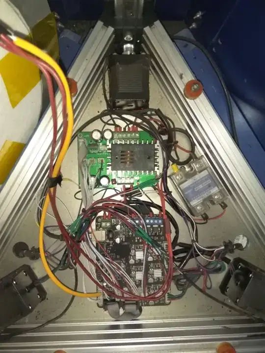

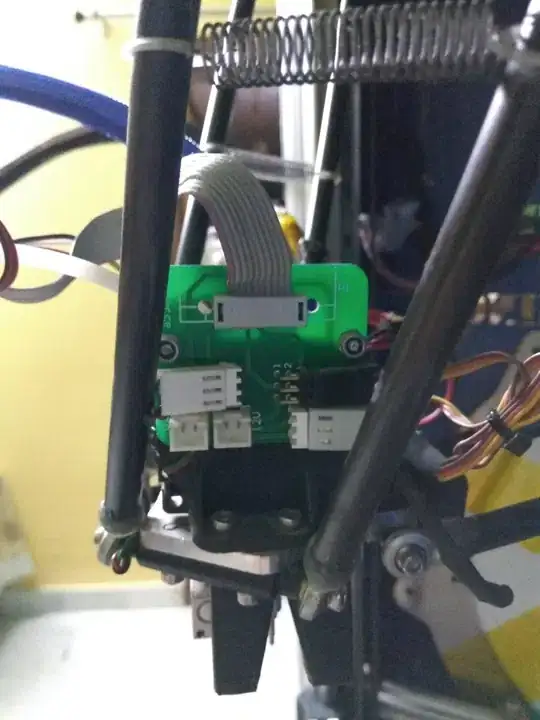

Sorry for the long, detailed and potentially frustrating question. I'm really new to this.
Edit: To be more comprehensive, I'm including pictures of the controller boards.
Main controller board
Hot-end PCB
Also, I've traced the printer down to a Taiwanese manufacturer: http://d-force.tw/
There are a few parts available: Hot-end PCB, Main controller board & Servo motor for calibration (Z-probe). I haven't been able to find the other board (with the HRD12008 SMPS on it and placed just beside the main controller board), yet.
Does this change things? If yes then how?
I'm going ahead with burning a new firmware on the current board only because changing the board and shield combo seems too complicated to me. Is it though?
