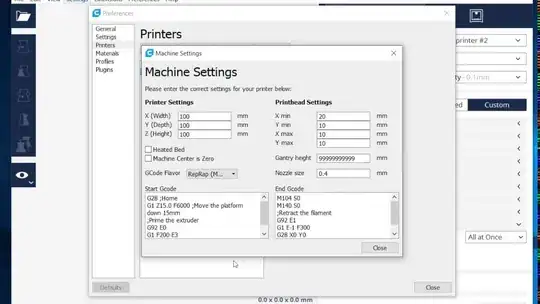

  1. I would guess (without G code) to change start G code. You should find it in Cura, the feed rate should be low there.
  2. Try other slicer and print from SD card.
  3. Try using other software. Try Cura it self if SD card printing is not available.
Picture is just an example what to look in Repertier or Cura. enter image description here
Martynas
  • 115
  • Please answer this with the respective given stats in mind: OP already increased travel speed and uses Marlin 1.0.2 with control via Repetier Host (with Cura Engine). Your picture is not Repetier Host. – Trish Mar 12 '20 at 06:40
  • The problem OP has is to do with Starting G-code, nothing to do with software. Offered to OP solution, change slicer and check if it's the same, look for starting G-code and change it because that's where the problem lies. – Martynas Mar 12 '20 at 09:00
