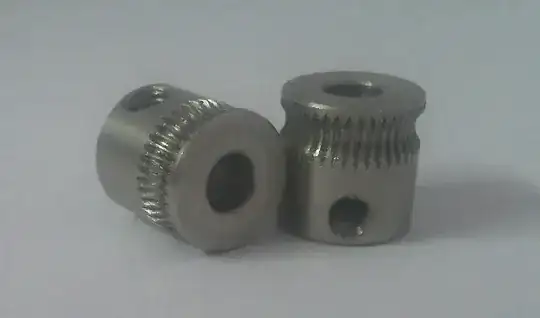

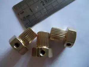

Any modern and decent drive gear (single or dual) is shaped round (concave) to better grip the filament.
Some are flat, but only the cheapest and least performing ones.
(from Reprap wiki)
The concave part designed for 1.75 mm filament will be too small to accept 3 mm filament, it will grip it so weakly that it will skip or skid very easily, especially given the increased grip required for 3 mm filament.
1.75 <-> 3 mm is a complete overhaul of anything related to the extrusion path. I did it so I know...
