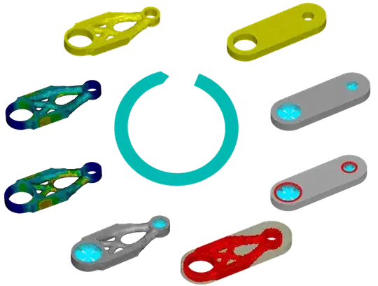

Next the more hard core cad tools such as solid works will allow you to preform Parametric optimizations and Topology Optimization. Topology Optimization. seems to be your real winner
Topology Optimization example

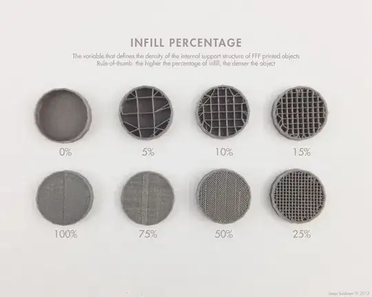

Now from the 3d printer standpoint we just simply tweak our slicer settings. There are entries for Infill. I usually print with 7% infill. AKA my print is 93% hollow inside. I then set a few solid shell layers. Think of solid shells as the skin. Usually that is enough to reduce my plastic usage. The only reason I don't make a part 100% hollow and a few solid skin / shell layers is that I need something to print on top of or if I need the part to be strong . Even low percent infill can be very strong if the correct geometric pattern is used (I.E. triangles).
Generally the reduced infill will be enough, unless you are making thousands of this item, though in that case you are probably not going to 3d print it anyways.
3dprintingforbeginners has a nice article on the relationship between infill, number of shells and part strength. A bit more information about the terminology (infill/shells/etc...) can be found on 3D printing blog.

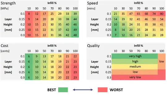

There is a great article on My3DMatter.com that provides details and a very interesting set of charts, outlining cost, speed, strength, and quality distributions at varying layer heights and infills.
Please Note: These results are going to differ between different material types, vendors, part shape, and infill pattern. These results were found printing from a MakerBot Replicator and presumably MakerBot-branded filament.
Infill vs. Layer Height Comparisons
