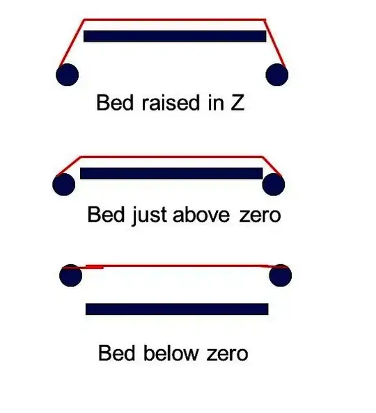

Here's a wild idea. Since you're planning to have a bed which only moves in the Z-axis, build a roller system which feeds a thin, flexible layer of some material (unobtanium, I fear) to cover the build plate. The feed rollers have a weak spring to provide some tension to keep this layer flat but not overly stretched while building the part. When the part is done, lower the bed to zero while allowing the roller to retract excess parts of the sheet (rollers on both sides of the build plate will have to do this). At zero, lock down the rollers and move the bed to some negative Z position, causing the overlay sheet to pop free of the bed and ideally pop the printed parts loose as well. demo concept
Hey, it "could" work!
