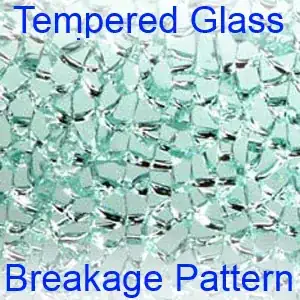

Another option, my favorite is Tempered glass. I have never had it flake apart as I try to remove from the bed. Also it is stronger, doesn't shatter into razers.
Tempered Glass break pattern
You can get more comparisons at Here
So go for it! But I would let it cool then remove parts. Be EXTRA careful removing the part from the bed. Oyster shuckers and the like are likely to break the bad while you handle it (Bad!) I will say in the long run a tempered plate will save you money. I have had some plate of tempered for over a thousand hours of printing on some of my printers. Including my Mendlemax and Dozens of HARD head crashes. Same plate from 2013!
