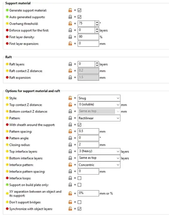

I'm using PrusaSlicer and these are my support settings:
Screenshot of PrusaSlicer's Supports settings
My settings are almost entirely trial and error since I haven't been able to find much good information in the realm of PVA support "default" settings, so I wouldn't be surprised if some things were wrong or different.

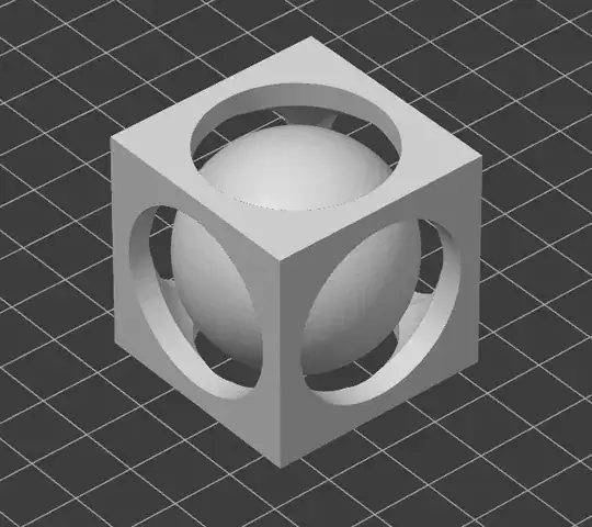

This is what I'm trying to print as my test print, a simple ball in a box:
A rendering of a sphere inside a box with round holes which the sphere cannot escape through
