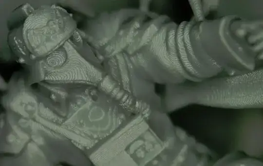

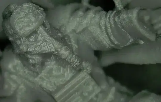

The linked site also provides these images for comparison of resolution settings:
47 micron resolution
100 micron resolution
