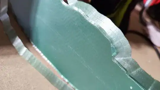

Here some pictures. Some parts are broken because I had already thrown it away. The bottom layer is quite good:

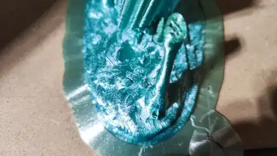

Details of the surface of the base:

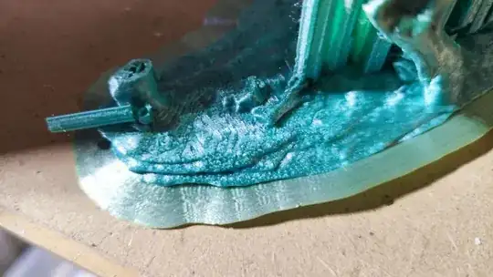

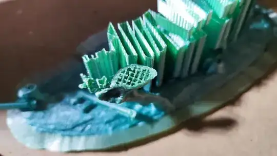

Details of the infill and support structures:
