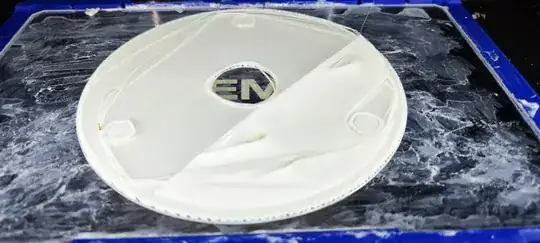

Instead now I'm facing another problem. After "some" (few or even after 10h) suddenly the filament does not stick anymore to the previous layers.
Here an example:
As you can see it completed the rafting very good (not sure if there also some few layer of the object) but then the new layer did not adhere and I had to stop the printing.

What can be the reason for such a failure?

  • The air gap is quite large! It is printing in the air with too less material. Furthermore it looks as if the print doesn't have supports as the filament sags on certain areas. Please add, by [edit] if there is support used. You could consider ditching the raft completely, this is an enclosed printer, you could preheat the chamber using the heated bed and use a large brim. – 0scar Sep 12 '22 at 07:00
    Is it in an enclosure? Maybe the higher levels are cooling too much. – Dave X Sep 12 '22 at 15:07
  • @Oscar question edited. I used supports and the air gap was the default one. Reducing it led to a better adhesion. And yes, the chamber was already pre-heated. I cannot use larger brim/raft because I'm at the limit of the build surface. – Mark Sep 12 '22 at 16:42
