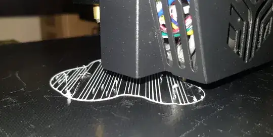

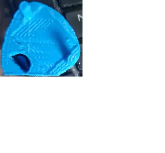

Here is a picture of the first layer of a raft:

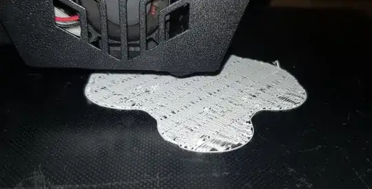

And here's a picture of a few layers in (still of the raft):
Just before this print I did an auto-level and cleaned the printbed with warm soapy water.

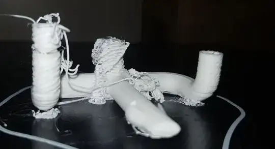

This is the print if I leave it going:
Additional Info: I used the auto-level feature on the CR 6 SE before any of the pictures and used Cura Slicer for slicing.

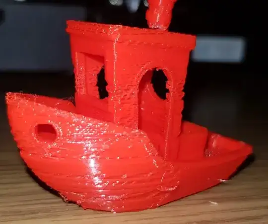

When using the hairspray method, I managed to get a print out - that print is a 3D Benchy:
Not looking too good. Also - as you can see, I used a different filament.

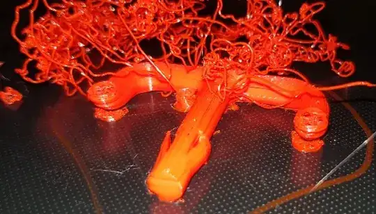

Using the hairspray again, I tried printing this:
But ended up with this:

The CR-6 SE uses strain gauge based sensing for the auto leveling. This implies that the nozzle itself is the probe for the leveling procedure. It is important that there is no filament left on the nozzle and no debris is on the bed (of so, this causes incorrect measurement of the bed surface and results in a too large of a gap between the nozzle and the bed).
Normally, when you replace a nozzle, you need to re-assess the distance between the nozzle and bed with the so-called "paper thickness" method.
This video of the CR-6 shows that paper is still required:
As seen from the first layer of the raft (which by the way is totally unnecessary for PLA) the nozzle is too far from the bed, you see this in balling up of filament and cutting corners where filament is dragged and not deposited. The video does show that it is required to set the Z-offset to the correct value during the printing of the first layer. It is advisable to decrease the Z-offset, alternatively you can set a Z-offset in the slicer, e.g. Ultimaker Cura has a plugin called Z-offset made by Fieldofview to set a different offset directly as slicer option.
You may also have an adhesion problem, probably caused by the incorrect distance, but an adhesive might be beneficial too.
Reprint and post a question on the quality of the print.
