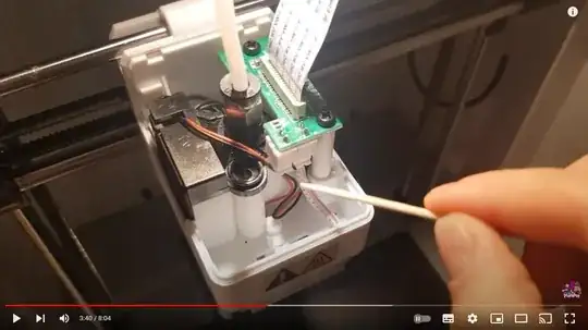

  • I've added an [answer](https://3dprinting.stackexchange.com/a/19701/), please look at the [video I linked](https://youtu.be/x-TyfVOtsg4?t=220), I think it is clear how you need to proceed to replace the part. Disclaimer; I don't own the printer, please be sensible, I'm not responsible for damages. ;-) – 0scar Jul 27 '22 at 11:46

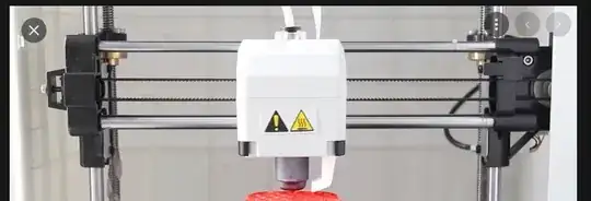

The image below shows the overview of the X gantry:

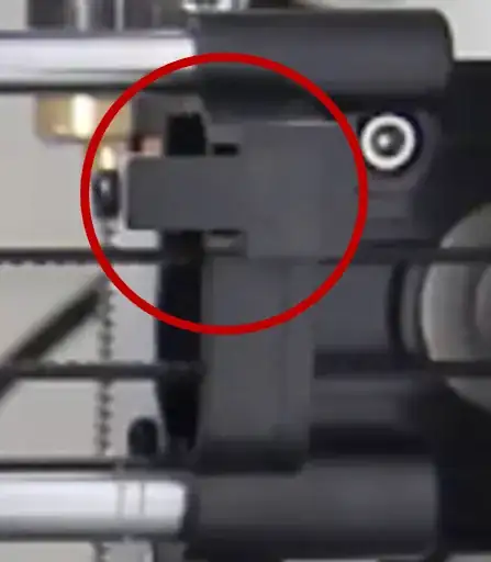

Note the flag on the right (encircled in red):

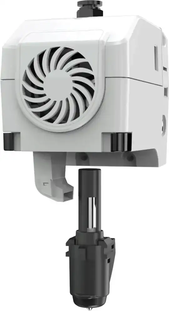

The flag enters (on homing) the rectangular slot on the top rigt, see below:
So, this is where the X-axis end stop is located. This implies that the print head needs to be disassembled.

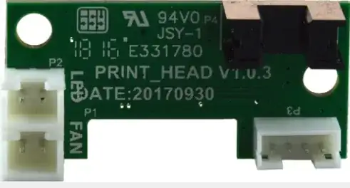

The X-axis end stop module can be found online as a replacement part, the back looks like this

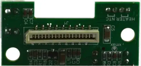

and the front like this:
It appears that you can take off the top of the printhead cover:
You will instantly see that the end stop module can be found there! It takes 2 screws to replace it (and some connectors!).
