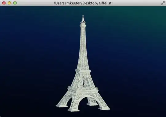

Using the search terms, "linux stl viewer," a number of results appear. One of the more promising programs, for Mac, Windows and Linux appears to be fast stl viewer, aka fstl. Image from linked site. Instructions included on the linked site to make fstl the default viewer for STL files.
fstl screen capture
