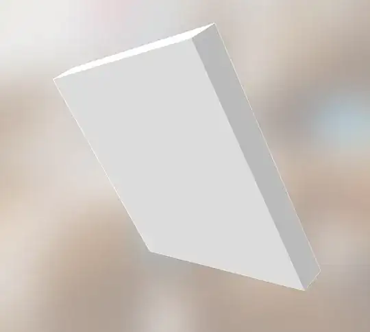

I'm a beginner to 3D design, and I'm well aware that my Autocad design was badly made. However, I've previously had no issue exporting Autocad designs to .stl, but with my current project, only part of the design is present. For example: example.
