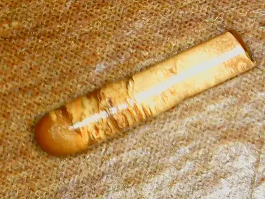

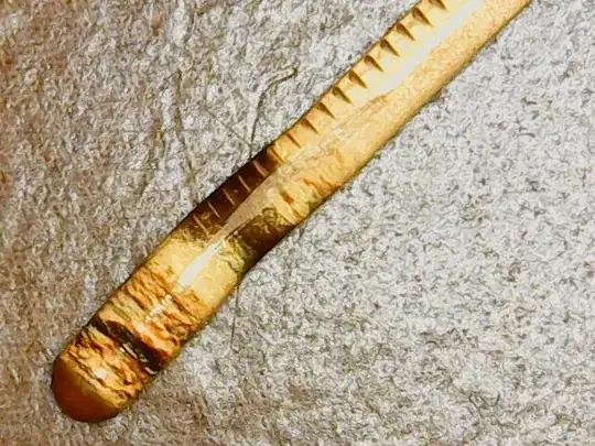

Some things I've noticed:
  • Prints tend to work fine for a while (~30 min to 1 hour or so), then the extruder is suddenly unable to push filament through the Bowden tube and begins to grind/click. There is very little to no period of reduced flow. It simply stops flowing completely.
  • I am unable to push the filament through by hand to clear the clog, but pulling the filament out and trimming the end works
  • The very end of the filament is the only place with any signs of being molten, well within the nozzle length itself
  • Pushing and pulling the filament in the hot-end by hand works for very small retractions, but can instantly result in a clog if pulled too far back (a few mm)
  • So far I have not seen particles / black buildup / other gunk that would explain the clogs
  • Letting the filament sit in the hot-end for a few seconds is enough to make it much harder to extrude by hand until enough filament is pushed through to clear what's melted (sitting too long will make it clog), but there are still no signs of heat-creep beyond the nozzle length.
  • I can always easily pull the filament out by hand after it jams (while still hot)
Examples of what the filament end looked like when a clog formed:
filament1
filament4
Since the melted material is so short I don't think it's heat-creep. Maybe it's the (very cheap) nozzles themselves having inconsistent dimensions? Not being able to retract a few mm and re-extrude by hand seems pretty odd. I have ordered official E3D nozzles to try in case they are the culprit.

  • When it has been up to temp for a half hour or clogs, can you try touching the heat break? If it’s hot it’s heat creep. – ChinchillaWafers Jun 18 '22 at 02:05
  • I'm able to touch the heat-break, and while it's warm I can keep my finger on it indefinitely. – Mandias Jun 18 '22 at 02:28
  • Have you tried increasing the hot end temperature after you increased cooling of the heat sink? – Perry Webb Jun 20 '22 at 13:47
  • Can you clarify why you deleted your self-answer? Did it turn out to be wrong? – R.. GitHub STOP HELPING ICE Jun 23 '22 at 14:52
  • Yes, per the Edit at the bottom of the original post I found that it only helped for some prints with relatively high/consistent material flow, but when multiple parts or small parts were printed it still resulted in clogs. – Mandias Jun 23 '22 at 19:48
