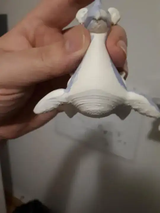

An easy example of what I got is a sphere object.
The lower half is messy with uneven surface, lot of visible strings marks at firsts layers. While upper part is just perfect. I tried to to work around it multiple times but can't find any worthy info on internet. Tried to slowing down the printing speed by max 50 %, thicker shell, nothing seems to work.
Here a Lapras I did to my son to show you. enter image description here

    Please add a photo to show the problem otherwise the question may end up being closed for insufficient amount of information to solve the problem. – 0scar Mar 05 '22 at 20:34
