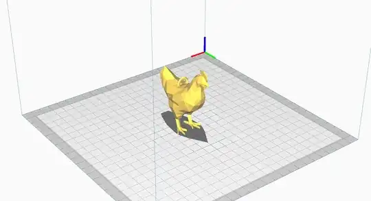

I have an Ender 3 Pro and I am trying to print a fairly delicate model of a low-polygon chicken as a Christmas ornament.
chicken ornament model

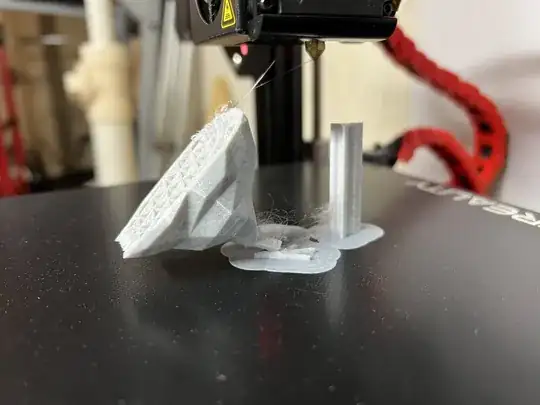

The first two generic materials are pretty crap. The gooping and stringing didn't occur nearly as much with the Eryone Marble. But that issue aside, the extruder keeps crashing into the print. The brim and increased wall thickness resist the collisions but eventually, the force is great enough that the print breaks:
print failure

I'm just not sure what else to do. I've never had this issue before on any other model I've printed. I used a level to ensure the bed is flat. I'm using a glass bed with great adhesion (clearly; the model breaks before it comes off the bed.) Instead of the Z-stop, I'm using the BLTouch, which samples 16 points before every print.
I thought that maybe moisture trapped in the material might be slightly increasing layer height with each layer, causing the print to fail after the same number of layers each time late in the print with a low layer height, but succeeding with a higher layer height. However, the ambient air temperature is 17 °C and the relative humidity is 44 %, not particularly high. Furthermore, different materials of different ages stored in the same location have the same failure. I don't have a dehydrator to be totally sure, though. I've been wanting to build one so this may be a good excuse. But any other advice or suggestions would be immensely appreciated!

  • Do you know if its the nozzle or the bl touch that hits the part ? Given the last layer is the widest so-far, I wonder if the levelling sensor is mounted low enough to catch it ? – Criggie Jan 01 '22 at 05:08

    @Criggie Thanks for the reply! It is the nozzle that crashes into the print. The BLTouch sensor in closed position is at least a couple centimeters above the nozzle hot end. – Micah Henning Jan 03 '22 at 21:37
