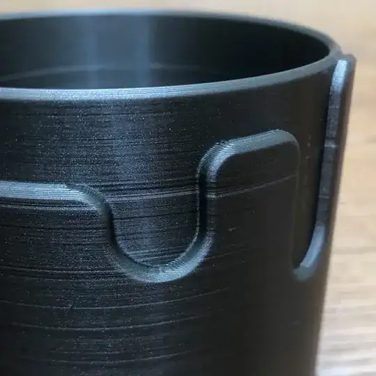

I have problems with layer widths and uneven outer walls on my 3D prints. Sometimes layers are squeezed and sometimes pushed outside. I noticed that these problems happen when there are retractions on layers. I don't have problems with round and simple objects without changes on layers or where all layers are identical.
Image showing uneven layers
I think that this can be linked with pressure in the nozzle or retraction. It looks like sometimes the pressure is too high and it's pushing too much filament and sometimes it's too low and it's not pushing enough filament. In this picture, layers in the first circle are squished in and it looks like there is not enough filament being pushed from the nozzle. In the second circle layer is pushed out and is wider than other layers. Looks like there is not enough filament being extruded at the start of the layer and too much being extruded at the end.
Image showing two areas: one with layer pushed in, and one with layer pushed out
This problem happens always on the same layers, where there are some retractions on these layers. I tried to print the same objects multiple times and it always occurs on the same layers.
Image showing squished in layers
Image showing squished out layers

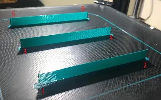

I calibrated K-factor with K-factor Calibration Pattern and discovered that lines are always thicker after retraction at the start of the line and thinner at the end of the line. Then I generated and printed test files to confirm this. My lines are always thicker at the start of the line and they get thinner later. This is the problem presented in the second picture.
I printed 3 cubes (dimensions of a cube: X=0.2 mm, Y=100 mm, Z=10 mm). This is the result.
Result of printing 3 cubes (X:0.2 mm, Y:100 mm, Z:10 mm)
This is the best representation of my problem. The order of printing was as follows: 1 -> 2 -> 3 -> 4 -> 5 -> 6 -> 1 -> 2 etc. There are under extrusions at the end of the second and third line (points 4 and 6) and under extrusion at the start of the first line (point 1). These under extrusions are before (points 4 and 6) and after (point 1) travel moves.
What can cause this problem?

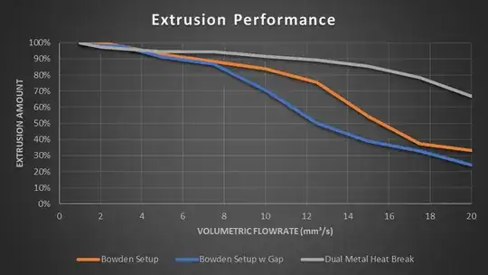

  • The slicer is set with a minimum layer time and the part is not big, resulting in a lower extrusion speed for smaller layers, and higher extrusion speed for larger layers (of course up to the value set in the slicer). When you have a Bowden system with single gear (like Enders do), the extrusion is not linear: the more you ask, the bigger the gap between what you ask and what you get. See this (orange line, from Testing bimetallic heat breaks):
    Flow rate and speed
    In other words, slower (smaller) layers extrude more plastic and look fatter. The way to solve is to get a dual drive extruder and by improving the quality of the hotend, for example by installing a bimetallic heat break (see grey line above).
In your case, image 1 and 2 appear to be related to variable extrusion, and image 3 to bed heating.
