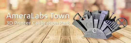

Consider to print a test model designed for resin printers prior to installing the protector. Perhaps print more than one, in different resins. Once installed, print the same sequence again and examine carefully for detail changes.
Another aspect of this "project" is that screen protectors are removable.
amerilabs test print
Image courtesy of linked site. Note that the linked site requires the user to sign up for newsletters in order to receive the free STL file, but one can immediately unsubscribe. Other 3d resin printer test models may be available.
The site has useful information regarding "reading" the printed model with respect to the results.
