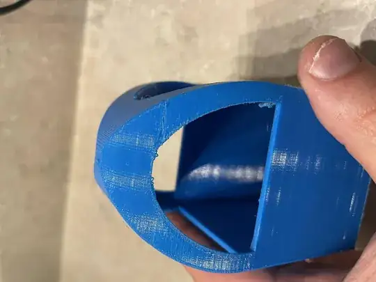

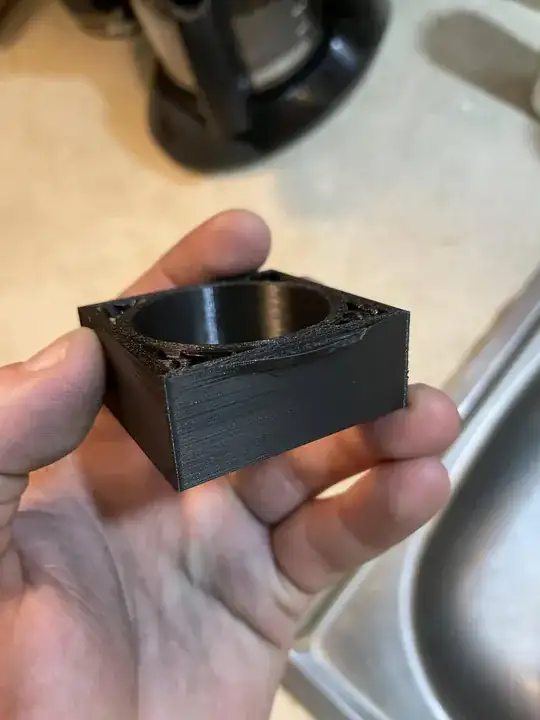

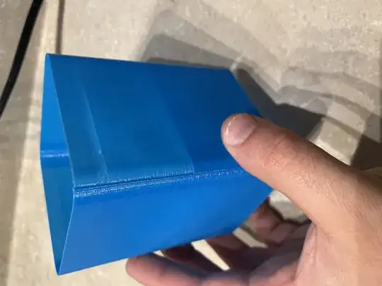

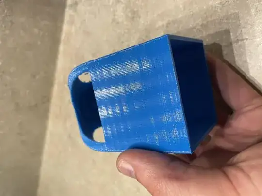

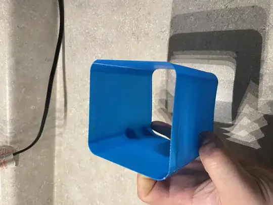

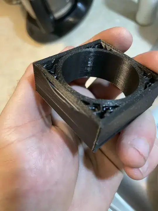

Here are some links to the pictures of a print I just started to test if I fixed the issue, unfortunately, I have not.
Example of delamination in printed part 1
Example of delamination in printed part 2
Example of delamination in printed part 3
As you can see in the pictures, it was delaminating. Unfortunately, it was just from some gentle pressure I applied with the edge of my fingernail.
I’m at my wit's end right now and have no other ideas of what to try to rectify this issue.

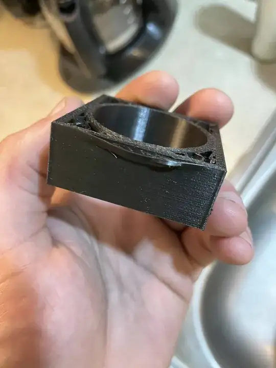

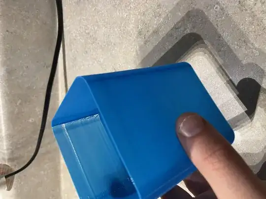

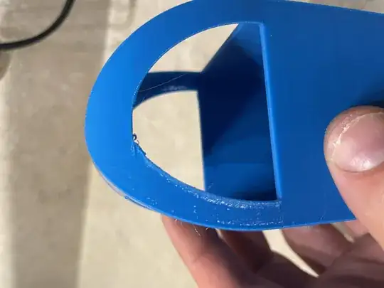

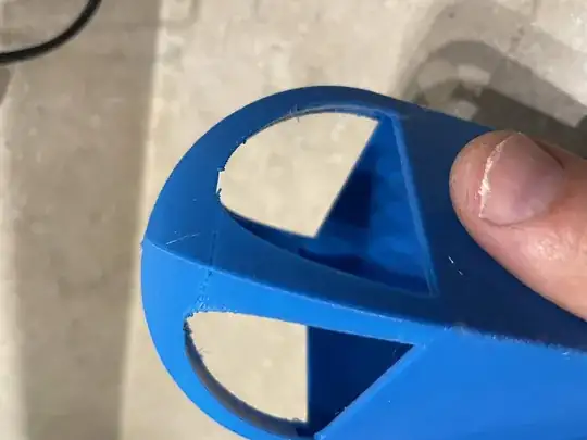

Edit: 6/23/2021- So after a test print, for some reason the perimeters I have not delaminated, at least yet, but I have found other oddities that I have not seen before. Do you have any suggestions?
I calibrated my E steps by following this video tutorial
I did it hot and with the nozzle on

    From the pictures, your prints look highly underextruded. Can you describe how you calibrated the steps-per-mm/extrusion rate? – R.. GitHub STOP HELPING ICE Jun 22 '21 at 21:02
  • Also, is it possible you have your filament diameter set wrong in your slicer? These pictures look *almost* as bad as what you get with the filament set to 2.85 on a 1.75 mm machine... – R.. GitHub STOP HELPING ICE Jun 22 '21 at 21:04
  • @R..GitHubSTOPHELPINGICE I came to the same under extrusion conclusion, do note the pulsating extrusion pattern. Seen this before in a question, when found I'll update the comment. It looks as if the stepper isn't powerful enough to lay down a consistent flow path. Be sure to look out for friction in the extrusion path. – 0scar Jun 22 '21 at 22:13
    If the bottom of the print is pointed up in the images, your initial z height may be too high. – Perry Webb Jun 23 '21 at 11:37
  • The bulge at one corner is also abnormal. How did you calibrate the E steps (elaborate in your question please by [edit]), with the nozzle attached and hot or without the nozzle attached. – 0scar Jun 23 '21 at 21:28
  • It can't be a coincidence that it started right after the extruder upgrade. Did the nozzle also change? Any chance it's a smaller diameter now? Any shavings in the extruder gear? – Curt Jan 03 '22 at 03:22
  • Do you use the same thermistor? Maybe the resistance changed and it's not reading the temperature properly. If you have an external thermistor, you could check the nozzle with that to verify. – RomanTenger Apr 29 '22 at 14:01
