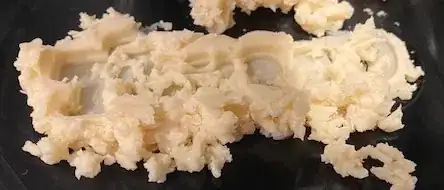

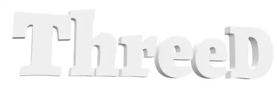

Also tried to print a word created Blender (MacOS), exported to STL, imported to Ultimaker Cura where it was sized and positioned, sliced and exported to a .gcode file. That printout seemed to be a mold of the object as opposed to the object itself.
Attached are two images, the 1st shows what was intended to print. The 2nd shows what actually printed.
What should have printed
What actually printed
If you can see past the globs and blobs, and look closely, you might be able to make out why it looks to me like a mold instead of the intended item.
Side note I noticed that when the printer stopped printing (to move w/o printing), the extruder screw pulled back 10 - 20 mm, which seems excessive.

  • Even in "Mold" mode, sure looks like excess extrusion and quite possibly higher temperature than your source material "likes." – Carl Witthoft Jan 14 '21 at 13:26
  • Excess extrusion seems right. It looks like that while processing. The temperature for white chocolate was set correctly (33°C) per instructions, but I imagine a little testing might make the a difference. Thanks. – WhatsYourFunction Jan 15 '21 at 20:38
Cura contains a few different so-called "special modes" which changes what the software does with your STL. One such special mode is Mold mode which, instead of recreating the object, creates a mold for the STL. It appears you may have that setting turned on, so disabling it will cause Cura to work as intended.

  • @DenisMuftic: Thank you for all the insights. Very helpful (Use of caps seems fine too). Re `Special Modes > Mold` -- That seems set correctly (Mold is not checked). Considering the manufacturer-suppled .gcode files printed properly, and only the Blender-created file printed as a mold, I suspect somewhere in the process of exporting from Blender through Cura to .gcode some kind of inversion is happening. Trying to learn and trouble-shoot. Thanks again. – WhatsYourFunction Jan 15 '21 at 20:37
  • I suggest to use the "Preview" in Cura to inspect generated G-Code before running the print. It is the 3d viewer of printer head extrusion with many great functions - for example you can watch printing layer by layer, or even move by move, using vertical and horizontal scroll bars. Or benefit from checking _Color scheme_ =Line type or _View type_ =X-Ray view. There are also online gcode viewers. I like [GCode Viewer (GCode Analyzer)](https://gcode.ws/), having very interesting 2D view with similar scrolls. – octopus8 Jan 16 '21 at 11:17
