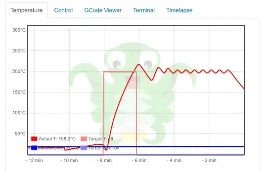

I have attached a picture which shows an initial drop (in response to a PLA preheat command), then a spike in temperature (hotend set to 200 °C, I had to manually stop it) then I ran a PID autotune, which completed normally, and received the values listed previously.
Graph - Temperature vs. Time
    Are you sure it is a 24 V cartridge? This awfully looks like a large overshoot due to a wrong cartridge ([I've had this once](https://3dprinting.stackexchange.com/a/13314/5740) where my cartridges got mixed up in my spares toolboxes). Please measure the resistance of the heater element. – 0scar Jan 11 '21 at 22:52
  • I did not think this was the case, the 12 V has a dimple at the end while the 24 volt doesn't. I checked anyway and sure enough the resistance was 14.7, so I'm still at a loss – westph21 Jan 13 '21 at 21:05
