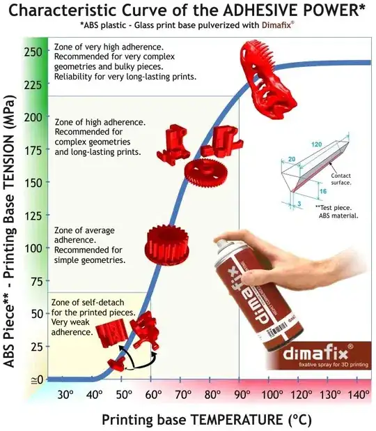

E.g. Dimafix has a higher temperature application range than e.g. 3DLAC. From the manufacturer can be seen that:
enter image description here Source: http://www.dima3d.com/en/home/dimafix/
This image shows that the spray has its maximum tack/adhesion at about 120 °C and holds this adhesion level at least up to about 145 °C according to the image.

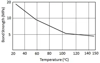

However, not all glues get stronger with temperature! PVA (also called PVAc) glues soften very quickly, making them good only at low temperature. See "Influence of temperature on the strength of bonded joints" which discloses this graph for PVAc Rhenocoll 3W, 4B Plus:
