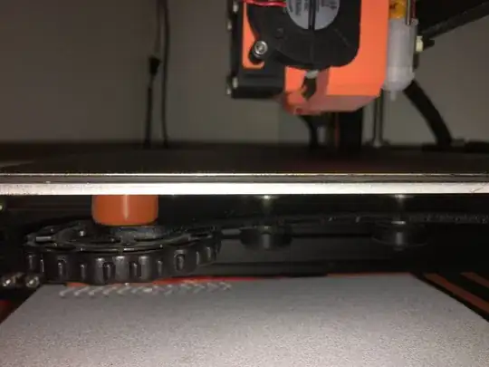

1i have a prusa mk3s the pei is double-sided (smooth/textured) and the sheet is magnetically attached to the y carriage.You can buy one magnetic rubber(the other side is glued to the y carriage) and then attch the pei to the rubber to make a removable surface.For me the textured pei works like a charm. – FrontENG Jan 06 '21 at 15:21
Yes,usually they just pop off when i bend the sheet. – FrontENG Jan 06 '21 at 16:44

Removable steel spring sheet with PEI textured coatings
I have been using textured PEI string sheet for most of my prints, just love it. Prints attach so good but not hard to remove(with proper nozzole Z-offset).
If the prints are small and seems hard to remove,heating up the bed helps a lot.
Almost never used the smooth side, even with proper z-offset, it still damages the surface quite fast.
Here's the link i bought before: Removal Spring Steel Sheet Pre-Applied PEI+Magnetic Base
This is my setup on a ender3pro:
