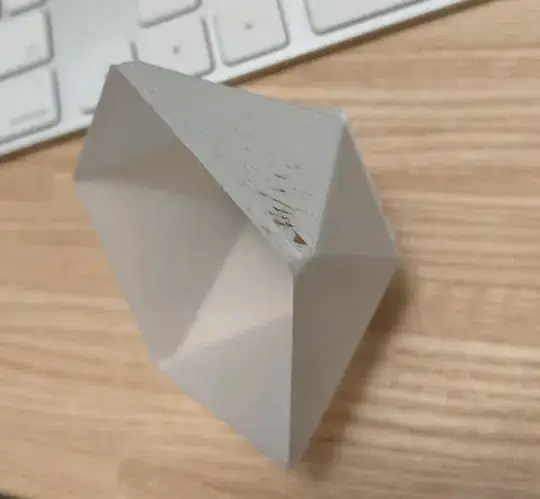

I have an FLSUN QQ-S Pro and I'm trying to print a part consisting only of thin walls with PLA. I'm using Cura 4.8.0, "FLSUS QQ-S" profile. Unfortunately, near the seam there are signs of underextrustion. It only happens near the seam, and after a few millimeters the wall is nice and smooth again.
underextrustion
Things I've tried:
  1. Increasing hotend temperature to 210 °C
  2. Setting flow rate compensation factor to 105 % (can't go much higher as the wall thickness will go up from current 0.4 mm - which is the desired result for this printer)
  3. Disabling retraction
  4. Enabling ironing
None of that helped. Is there some way to push filament a little bit forward at the start of each layer?
