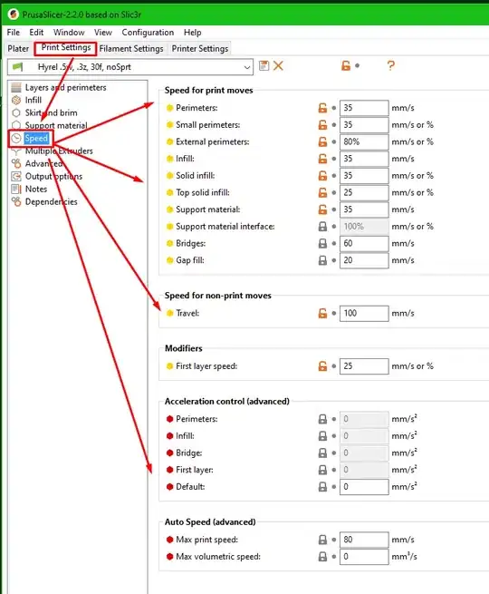

Here's where you change the speed in Prusa:
Changing Speed in Prusa
As Trish said, you're likely trying to push too much material through too fast.
Steps you can take:
  1. Increase print temp
  2. Decrease print speed
  3. Slice for thinner layers
  4. Don't forget to adjust your nozzle diameter and/or extrusion width(s) as well.
I'd personally start with increasing my print temp 10 degrees and cutting my print speed in half, as well as making sure I had 0.2 mm nozzle and extrusion widths.
