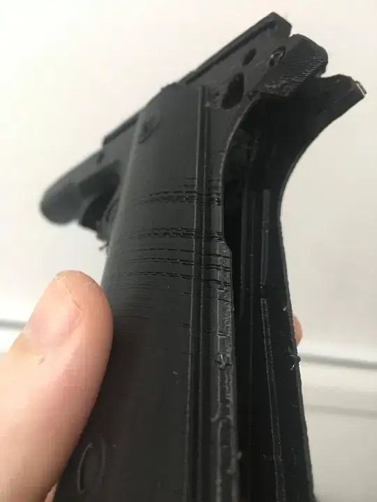

I have been testing my brain for the last few weeks trying to solve this problem: Under extrusion Some info:

At first I assumed it was related to linear advance, however, decreasing it did help it reintroduced bulging corners. Then I noticed the geared extruder clicking(only sounded like vibrations caused by fast print speeds) during the Linear Advance retractions/deretractions. I then tried significantly lowering the max extruder feedrate/acceleration/jerk (jerk wasn't actually listed in the M503 but I still tried sending the G-code to change it) in firmware, which did stop the clicking (skipped steps?) but not the under extrusion. Also im curious what the "Jerk Contol" settings in Cura actually do since I'm using junction deviation and if I should be using the lower values(0.02-0.1) that junction deviation calls for over the higher(5-30) ones that classic jerk does.

  • Seam: Expose seam(seemed to have the largest effect overall (but only on the calibration cubes,the reciever seen above also has the expose seem option enabled see:https://imgur.com/gallery/dRjptkp)

  • This might be a Marlin bug. There were several like this with JD, LA, and S curve and last I checked S curve with LA was not supported unless you do an experimental override. – R.. GitHub STOP HELPING ICE Jun 29 '20 at 22:36
  • It could also just be lost material inside the model from combing. Try turning combing off in the slicer or setting a very low distance limit (~1 mm) on it and see if the problem goes away. – R.. GitHub STOP HELPING ICE Jun 29 '20 at 22:37
  • Since lowering LA helped I'm guessing it's the LA+JD bug in Marlin. – R.. GitHub STOP HELPING ICE Jun 29 '20 at 22:38
  • I think you were right about oozing material. With combing off ,1.5mm retraction and 0.6mm Z-hop preliminary tests look to have solved this issue, however it did noticabley lower surface quality which is also not ideal. Im going to experiment with longer than 2mm retraction lengths even though it is commonly advised against for direct drive setups. Im guessing the retraction just isnt long enough for this Volcano/Titan clone. – snug Jul 01 '20 at 00:17
