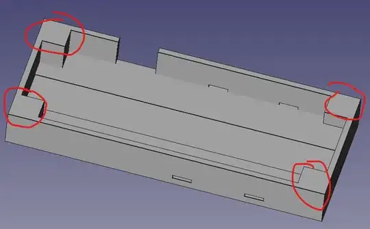

Essentially, I have a need to design some housing for a small electornics board. Due to the nature of 3D printing being less than ideal for bending/snapping locks, I've decided to use small screws to hold multiple layers of housing together. Placements to bore threaded holes
SketchUp Free proved to be a super intuitive, easy to understand 3D modeling software, tho is limited in functionality due to paid tiers. Unfortunately, FreeCAD felt like a confusing cross between early 2000s Microsoft Paint and Eclipse (Java). However as the open source alternative, I understand it's incredibly powerful and can/should be able to do what most 3D modeling software is capable of, if you know how to use it properly - and that's where my lack of understanding shines through. Research into my use case revealed a plugin (Fasteners Workbench) which seemed purpose built for dealing with screws/threads, and I greatly prefer this approach due to being able to select standardized sizes.

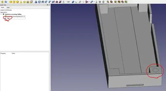

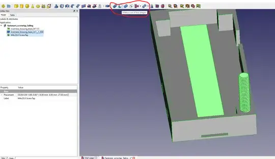

On to the problem: I decided to sketch out the main design for the housing in Sketchup, and am happy with it, though I am missing the holes in the four corners. To add this, I decided to export the file from Sketchup as STL and import it to FreeCAD. Once in FreeCAD, I switched to the fasteners workbench and created a screwtap of arbitrary length. Now, from most tutorials I've watched, removing one piece from another is a boolean operation, often a cut or an intersection. However, when I highlight both the part object and the screwtap and select the CUT boolean operation, what I expect to happen (the screwtap was "cut" or carved out of the part object) did not. Intersecting components selected, deciding on boolean operation enter image description here
I'm wondering if: - My understanding of the boolean operation is wrong. There is a different function that is used for "boring" threaded holes? - My process is wrong. Does exporting an STL from sketchup free not work for certain operations when importing to FreeCAD? - My models are off. I have an understanding that "grouping" parts of models is big when putting a model together from parts, so as to simplify life. I'm wondering if it's also required in these cases? Attempting to do the boolean operation in sketchup failed but did require having grouped components. I'm not sure this is the case in FreeCAD, or if I'm already doing this?

Stls may not properly import as solids. This is likely what is happening in your case. Stl format is ultimately just a bunch of triangles without a proper definition of a solid. The boolean Difference found faces to attach to the circle so it used them. The trouble is, there were even more faces at the same location (not uncommon).
You could manually delete and repatch the triangles in Mesh Design or if the shape is simple enough (I think your box fits the bill), redraw it. I don't know how far sketchup has come with file formats, but a different format may convey your solid better between software.
That said, in your shoes, I'd be making cylindrical and hexagonal cutouts and gluing a nut into my part.

There are a number of steps to importing an STL file into FreeCAD and being able to use it. This page discusses this in detail, but to summarize:
  1. Import the STL
  2. In the Part workbench, use Create shape from mesh.
  3. Use the Advanced utility and select Solid from shell.
Now I will tell you from personal experience, you still may not be able to what you want to do. FreeCAD really isn't designed to work on STL files and really isn't the right choice.
