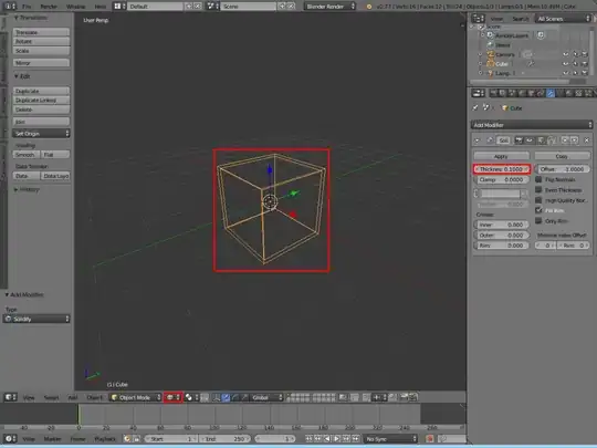

You are correct about the walls. Using a Solidify object modifier is probably your best bet. A low Thickness: value (0.1 is probably good) helps keep the walls thin but strong. You can monitor the thickness while you adjust the value from Wireframe view.

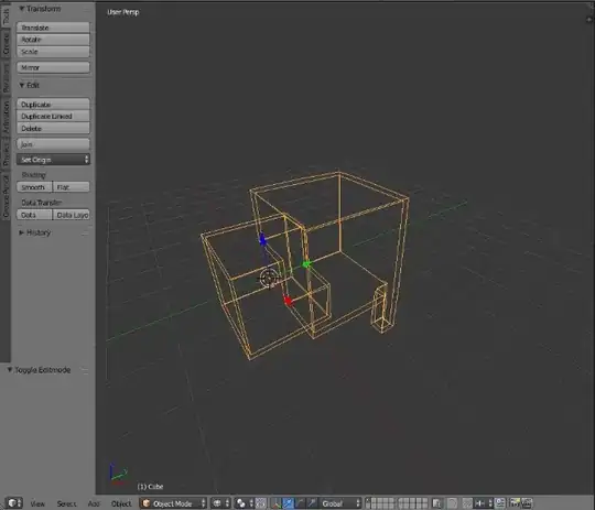

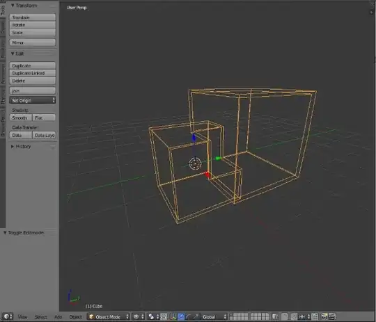

Additionally, and this is probably the most important thing to know, your mesh must be clean. By clean, I mean it must all be one piece. No separate cubes, cylinders, etc. that you added while modeling, just one solid piece. Think about it this way. If you have added a cube and part of that cube is inside the rest, it might look good from the outside. But the 3D Printer isn't printing the outside, it's printing everything. So that wall, albeit hidden, that is present on the inside of your mesh will be printed.
Bad:
Good:

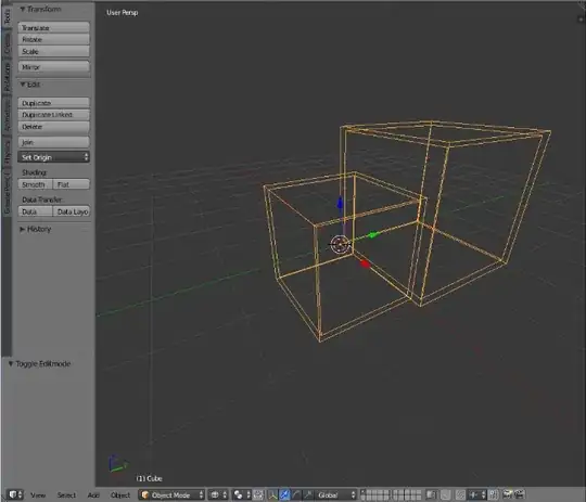

Lastly, if you have parts of your mesh that can't be printed from the bottom up, or wouldn't stand by itself, consider adding supports. You can always cut these off later.
Leg added because it wouldn't stand by itself:

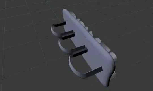

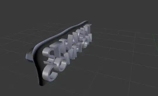

  • I have attached 2 images if you look up, i have another question. How should i place my object for printing? Should i put the text side face down so that it has something to stand on? –  Jun 06 '16 at 19:52
  • @Ulus That would probably be best. If my answer helped, please consider accepting it. –  Jun 06 '16 at 19:53
  • Thanks again, for answering. Also i dont want the object to be solid inside, so would it be best to place a hole behind it? (I saw people do this in video tutorials )And if so where would be the best place? Please let me know if you have an idea i would be pleased :) –  Jun 06 '16 at 19:56
  • @Ulus A hole? The solidify modifier will ensure that it is just walls. Do you want to be able to stick something inside through a hole? If you do, perhaps in the middle-back of the blocky mesh, underneath the center handhold. –  Jun 06 '16 at 19:59
  • Hm ok, i guess extruding and re-sizing the duplicated mesh to the inside will also work, then i will use a Boolean modifier to make a hole with a cylinder, that should work :) –  Jun 06 '16 at 20:07

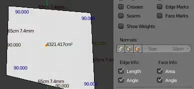

It's a good idea to check if the dimensions of your mesh are correct before exporting:

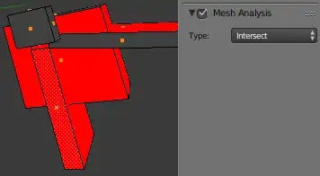

Turning on mesh analysis allows visual inspection of problems such as intersecting faces, sharp edges ,edges with thickness below a threshold and other criterias.
the inspection tool will color the faces with those problems.

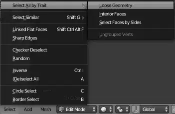

And lastly you can make selections by traits, such as loose geometry, interior faces or unconnected vertices.
note that those are just tools to help you find the problems , none of them will fix the mesh for 3d printing.
