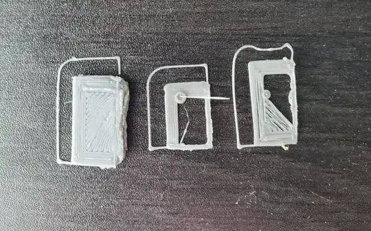

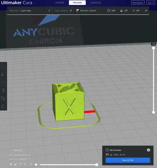

Just took delivery of a massive Anycubic Chiron to my house and have been trying to get it printing successfully for supplies for fellow clinic staff. For some reason, it is only printing a portion of the test shape that Cura is putting out. I am using 1.75 mm ABS Filament, with an enclosure and proper adhesion. Attached is the preview image from Cura. The next pic shows what the printer is actually laying down, some sort of rectangular crop of the test cube and skirt. I just stop the print when I see it repeat the issue.
Cura Preview Printer Output Printer

  • It is printing the whole object, but the print head is not moving far enough reaching all the coordinate it is supposed to go to. It looks like the carriage is not moving freely. Remarks that have not to do with the problem you are facing: 1) Flow should always be 100 %, if you need to change it you probably need to calibrate the extruder. 2) Also, 1.5 mm retraction might be a little low for a Bowden setup. – 0scar Mar 25 '20 at 08:13
  • I agree with @0scar ... this looks like a mechanical issue, where the extruder isn't traveling where it needs to go to get the job done. You might try re-slicing the object, placing it in a different position on the bed, moving it away from the side which is producing the sharp corner. Also, the extrusion is ugly. You'll want to double check your bed to extruder clearance as it looks like they are too far apart. You aren't getting enough squish which is causing you gaps in your initial layer. – Pᴀᴜʟsᴛᴇʀ2 Mar 25 '20 at 10:51
  • Please see comment left below for Carl. Also, for reference, the print on the left is the most recent. I spent some time manually leveling the bed until it was squishing better and that seemed to make an improvement. I face an issue though where the nozzle is rubbing up against corners/edge and burning that area. – nuggetchris Mar 25 '20 at 19:17
It looks like either the mechanical travel is constrained or, possibly you have the origin of the X-Y plane in the wrong place in Cura. Usually Cura won't even slice if it thinks the object extends past the printable area, so check the display in Cura "Layer View."
If that's OK, then try using the control panel on your printer to manually drive the print head all the way in both X and Y axes. If it doesn't then the commenters are correct thatyou have a mechanical interference somewhere. If it does, then somewhere between Cura and your printer the "soft limit" of maximum excursion is set wrong. I'm not familiar with your printer model, but there should be a control panel command to "zero all axes," and typically the origin is the front left corner of the build plate (facing the printer, so "Stage Right" in theatre coordinates) .
