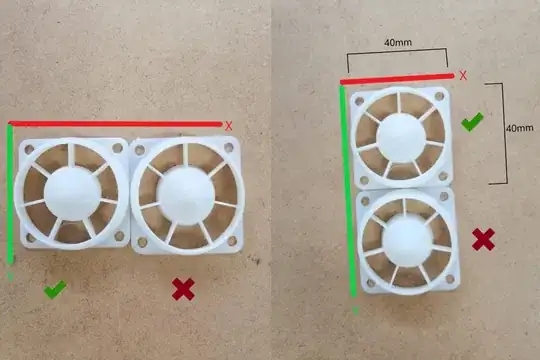

  • I ran two of them, one on the printer with the issue and one on a perfectly functional printer.
  • They were run this morning, in identical conditions and started at the same time.
  • There are no other structural defects aside from the stretching, it simply looks like a normal, print but as if someone used the photoshop transform tool and pulled it.
Here is a side by side of the two finished prints, comparing them along both the X and Y axes. As you can see, the X axis is perfect on the problem print, but the Y is consistently stretched (visible in the shape of the round cone and the screwholes).

  • So, what I've now done is extruded two dots, and moved the y axis 70 mm between them (according to Marlin). Using calipers, the actual distance between them is 72.55 mm (pretty out of whack), so I used [this](https://i.imgur.com/xliKC8W.png) formula to find a new steps/mm value for Y: 77.18. I re-ran the test and got a slightly too short distance, so I've re-done it one more time and left another one of the original prints. Problem solved! – Finn Mar 19 '20 at 23:44
  • You should not change that Y value if it read the same as for the X! You have a hardware issue! – 0scar Mar 20 '20 at 06:24
  • @0scar Changing it down slightly resolved the issue entirely, what other solution would there be? – Finn Mar 20 '20 at 06:36
  • You probably need to replace the belts and ensure in the future to not over-tighten them. – 0scar Mar 20 '20 at 08:25
  • @0scar Alright, thanks. I'll definitely look into replacement belts in future! – Finn Mar 20 '20 at 09:18
If an axis doesn't print the sizes you command it there are basically 2 options causing this.
  1. The printer is incorrectly configured,
  2. The printer has an hardware issue.
To find out which of the 2 is applicable, you need to look into your setup and into the firmware settings. E.g. from the printers display you can read the amount of steps the stepper needs to make to move the axis 1 mm. Alternatively, send M92 through a terminal and look at the steps per mm. If X and Y are the same, the firmware is correctly configured and you are facing a hardware issue. Note that for the stock Ender 3 the value for X and Y needs to be 80 steps/mm. Do not alter these values!!! These values are based on the mechanical layout and the micro-stepping used by the stepper drivers.
Since you have flashed a stock hex firmware file it is highly improbable that the firmware contains the incorrect steps per mm value for the Y axis (unless you accidentally changed this through the interface/display). This leaves you with a hardware issue. Common reasons that could identify the source of the problem are:
  • Loose grub screw of the pulley on the stepper,
  • Missing steps, e.g. due to too much friction (if dimensions are smaller, in your case this is not the problem, it is added for completeness),
  • Loose, under tensioned belts,
  • Stretched belts as a result of over tensioning the belts.
Considering the stretched Y dimensions, the most logical explanation would be that your belts are stretched, you cannot fix this by changing the steps/mm value, it requires mechanical attention; i.e. replacing for new belts.
It is likely you have PU belt and it is likely it stretched in some area. I had all my PU belts finally stretched with big tension and high speed printing. Now I am using reinforced rubber belts.
