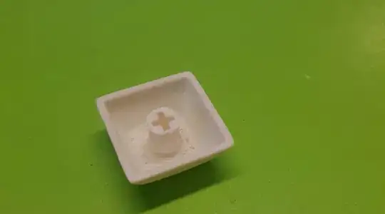

My model is a keycap for mechanical keyboards. There is the cap itself, and a stem with a hole in the form of a cross, which fits the switches themselves.
Print at bottom, the other caps are reference
Bottom view
I print in the same position as it is intended to be used, top up. This means that the stem and the cap are not connected until quite a few print layers.
To prevent the stem from falling off during the print (it has a small footprint), I created connectors in the first layers, to hold it in place. enter image description here

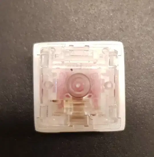

The issue: it seems like all my prints have a rotation of the stem, compared to the cap. It probably rather is the cross-shaped hole, or its walls, that are not completely symmetrical. I do not think it is only the edges against the printing bed that are the cause, since I have trimmed them with a scalpel. The rotation is always in the same direction.
The twist is detectable when watching the keycap with the switch, and more so with keycaps on switches on a keyboard plate (you can see that the edges of the caps do not align. They do in my CAD program): Bottom view with switch enter image description here

This looks like a shift rather than a twist.
Looking closely at the "+" opening, it doesn't look as much twisted as it looks as if the top and bottom halves are sheared, with the top half shifted slightly right and the bottom shifted slightly left. The horizontal part of the plus seems aligned on the left and right halves.
When you press-fit the keycaps, you will "average" the displacement forces and the keycap will twist.
I am suspicious of a backlash problem in the X axis (left to right). Perhaps the belt isn't tight enough, or some part shifts differently. It could be in the rails, the belt, a loose drive pulley, the hot end being slightly loose on the carriage, or any uncontrolled movement. It could be a high-friction x-axis which causes spring wind-up in the drive system.
I recommend carefully examining the printer for any excess friction or movement, and taking action to fix that first before tweaking the model to compensate for what can not be fixed.
If it is a twist, use more cooling.
If the photos have misled me, and the vertical "+" shaft if actually twisting, you may need to use higher cooling. The drag of the filament as the head traces the perimeter can create a torque on the shaft, and if the plastic is not sufficiently cooled it could be dragged around. I consider this more of a theoretical problem than a real one, and have not yet seen it in practice.
