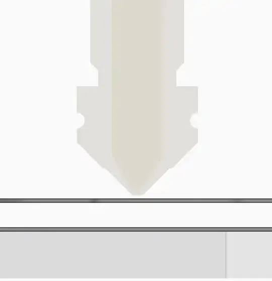

I'm trying to do a multifilament print on my single extruder machine. So I separated out the models based on filament, and imported the parts into Cura. I ensured that "Automatically drop models to build plate" was disabled and in the "Prepare" phase that seems to work. However, when I slice the model it gets pushed back down to the build plate as can be seen in the picture below. Any recommendations? Do I just need to write a script to go in and shift the z location?

I've been playing with this and came up with a solution, so I thought I would share in case anyone else had this issue in the future. In Ultimaker Cura I enabled supports and z-hopping before I sliced the part, then I ran this Python function to remove the supports and get the extruder setup.
