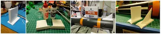

A strong epoxy like BSI 5-15 min works great for me. I use it to bond high power rocket fin halves printed from PETG:
