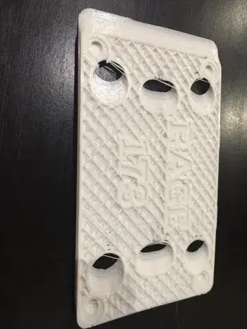

My school started a robotics club this year and one of the teachers gave us an Ender 3 printer to use, they assembled it the year before but never actually used it so it was sitting in their garage, I attempted to print several different objects but all of the larger ones seem to suffer from layer shifting on what seems like the Y axis. I've looked at other threads and tried stuff such as changing the binder clips (add adding more), leveling the bed (again), tightening the belts, moving the print position to a corner, using a different slicer, and reslicing the models which all fail, when I print smaller objects, it prints fine. What could the problem be and what can I do to resolve this? I'm using Cura 4.4 currently.
Failed print:
failed print

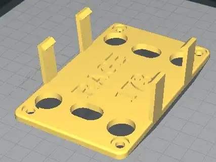

What it should look like:
cad image

  • Is the Y belt tight? What are your jerk and acceleration limits set in the slicer? – R.. GitHub STOP HELPING ICE Jan 25 '20 at 22:39
  • @R..GitHubSTOPHELPINGICE Yes, I tightened both the X and Y belt, print jerk is 20mm/s and acceleration is 500mm/s I'm using the Magic0.20 profile from https://www.chepclub.com/cura-profiles.html (had the same issue with the default profile) – Puyodead1 Jan 25 '20 at 22:44
  • Do the cables of the bed get caught on something? Does the bed run smoothly without the belt? What is the print speed? – 0scar Jan 27 '20 at 10:54
Fixed it finally, seems that the X axis was not level. Thank you to everyone who commented.
