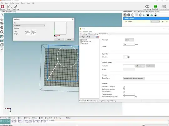

How can I set an offset in y or x axis so that I can move the position of my printed object. I have tried doing this with so many options in Repetier, and in Slic3r, and still nothing, please, have you got any ideas?
First Edit: I have added an image of the changes I have done, nothing of this works for me Image of RepetierHost and Slic3r

  • I don't see that option, I have add an image of my configuration of Repetier host and Slic3r. I have tried something similar of what you say, but is not working for a strange reason – Dauph May 17 '16 at 00:33
  • @Delfin File > Preferences > Auto-center parts – darth pixel May 17 '16 at 04:33
  • @Delfin i just realized that your screen comes from Repetier so you should rather go Config > Preferences > Object placement > Auto position object... – darth pixel May 17 '16 at 09:33
