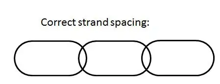

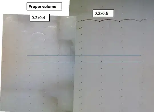

The goal here is to fill the print volume as completely as possible (at least in the "solid" parts of the print like perimeters, roofs, and floors). Empty space between strands doesn't contribute to part strength. In fact, voids act as failure initiation sites by concentrating stresses. Because extruded strands come out with rounded edges, they have to be overlapped to squeeze plastic into gaps and minimize "corner voids." That looks like this:
Where the bulges overlap, the excess plastic gets pushed into the corners to mostly fill the voids. It's very difficult to get 100% packing density, but you can get pretty close if you calibrate volume correctly.

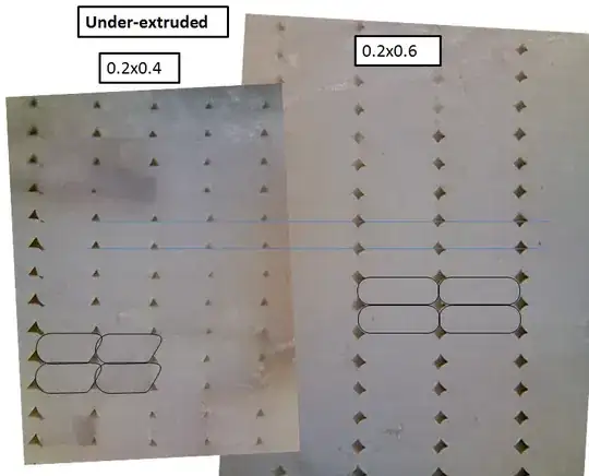

You DO NOT want to space the strands without overlap. That makes very weak prints and looks like this:

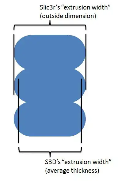

To get the right amount of strand overlap, the slicer has to do some math and make some assumptions about how you're calibrating it. This is not uniform between software packages. So it's important to understand what "extrusion width" means to different slicers. For a couple prominent examples:
  • Slic3r treats "extrusion width" as the measured outside dimension of a stack of strands. Adjacent strands are then positioned closer together than the nominal width according to a somewhat complicated equation to get sufficient overlap for bonding.
  • S3D treats "extrusion width" as the average width of the stack of strands, which is the equivalent width if the plastic strands were extruded as ideal rectangles instead of a stack of ovals. Adjacent strands are positioned 1x nominal extrusion width apart. That provides the correct amount of overlap without any extra math. But each individual strand is really somewhat wider than the nominal "width."
Both of these techniques can produce the exact same output if calibrated properly, but they require different calibration techniques because they calculate the plastic volume and adjacent strand spacing different ways.
It's important to understand that S3D spaces its strands 1x extrusion width apart. When you use the measured perimeter thickness to calibrate Simplify3D for extrusion width setting = measured thickness, you get under-extruded prints with no strand overlap. S3D's strands must measure wider than the "width" setting to get the correct overlap.
