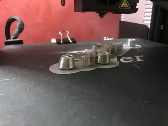

I'm printing a model on my Ender 3 in Mika3D Silk PLA, which (just for reference, this is not atypical) has a stated temperature of 200 °C to 235 °C. I have used this filament before and found it works best for me around 200 °C, but was not the case with this print, and I'm wondering what else I can do to fix this issue.
I have retractions enabled, have lowered the printing temperature to 180 °C and decreased the feed rate significantly, to around 75 %. Both of these adjustments happened gradually, making sure there was no change in stringing between adjustments.
I do have rafts and Z hops enabled in Cura, as previous prints of this model were knocked off the base even after leveling the bed properly, and almost every time a "hop" is performed, some stringing occurs. Is there something I can do in my settings, etc, to fix this issue?
Here is an image of the problem. Image of print with stringing
Edit: did some extra research and increased my print speed and switched to a better testing model - same issue.

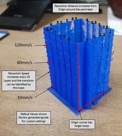

There is a tool designed to properly tune retraction: http://retractioncalibration.com/
What it does is print a tower with multiple retractions with increasing retraction distance around the perimeter. Along the Z axis the retraction speed is increased. This tool does not include Z-hopping so stringing may be less visible, but at least you can easily visualise the optimal retraction settings. At that point if the optimal settings are much different from what you had, you may want to try your model again to see if it improved.

It's because the nozzle has nowhere to wipe itself, like when you don't use Z hop the nozzle wipes itself off in the inside of the print. When you have Z hop enabled the nozzle has nowhere to wipe the string off, which leaves a string when it goes over to the next print. This happens to me all the time.
What improved the stringing issue in my case was increase the amount of retraction on top of the temperature reduction.
