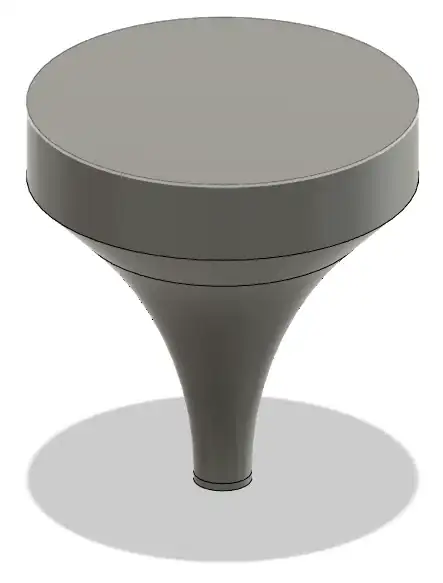

Surely! First of all, a mold is, simply put, the negative of the item. So we need to make such a negative and give it some thickness. I have this funnel model...
A simple Funnel

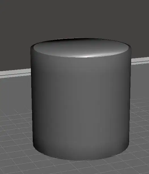

We start Meshmixer, import our funnel and then go into Meshmix and pull a cylinder into the frame. We size and align it to hide the funnel but for a tiny part at the top (or however much you need to have covered in the mold)
Funnel (light) in the Cylinder (dark)

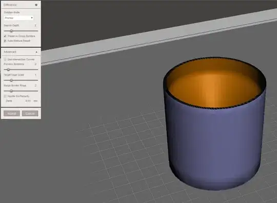

We choose "Boolean Difference", the menu changes to show this:
just after pressing the button...

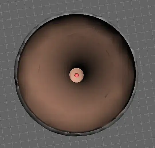

Next we alter the Target Edge Scale till we see the top corner (0.6 seems to work) then accept. The result is this mold:

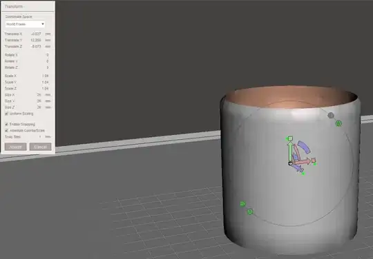

    • Use those square boxes marked with green dots to pull
Transformation window

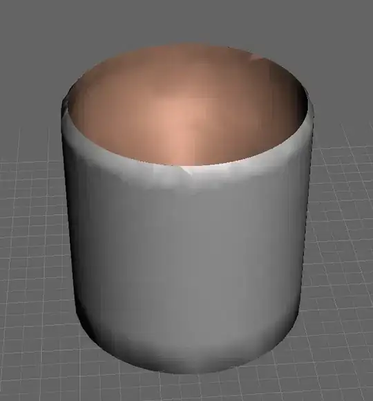

Accept and... DONE! Last to do: export as STL and here you go! a Mold that is 4% larger and could be a cap for the funnel.
