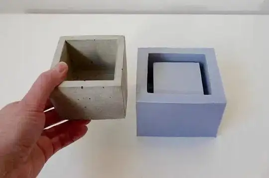

I want to make Polyurethane molds for concrete using 3D printed PLA or ABS master object. like this video:
(this video is not about concrete of course!)
I'm not sure if it will stick to PLA or ABS master or not! if it does stick, whick wax material can solve this problem... Do I need to print my masters with another filament?
