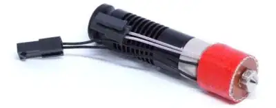

Let's suppose I want to build a water block shaped exactly for my Ubis 13s hot end
Ubis 13 hot end
(similar to this instructable), or that I want to circulate water around specific objects to be cooled (like Water-cooling stepper motor with aluminum block).

  • Oooh... I hadn't seen that hot end design, but I really like it. A big limiter to print speeds is the mass of the print head. Smaller/lighter print heads allow for faster movements with fewer "ringing" and jerking effects at the changes, and this hot end looks very light. Couple this with the comment where they also allow some fanless printing (perhaps a much larger fan on the frame to help), and you could end up with a **very** light print head. – Joel Coehoorn Sep 30 '19 at 13:48
  • My plan is to enclose the printing chamber for ABS/nylon printing (and I use trimmer line, which curls even more than normal nylon), so external cooling would be required. Also, I would like to avoid air flow from the hot end fan so close to the printed part. However, the question is about the material, it may be useful in other cases as well. – FarO Sep 30 '19 at 13:57
