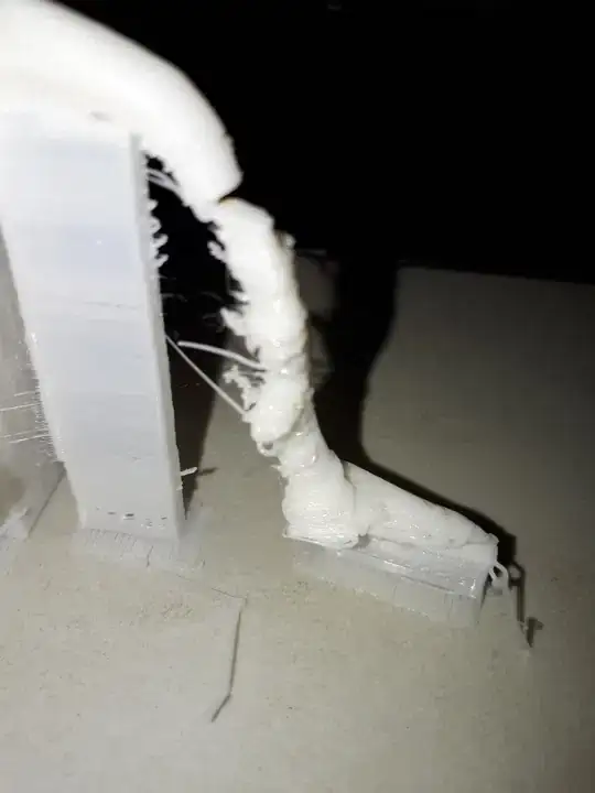

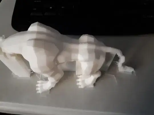

I'm using a Prusa Slicer with a FlyingBear Ghost 4 and got a wrong printing alignments on the Y axis only on a part of the printing object. What may cause this?
Here are the printed model pictures showing the problem:
Photo of 3D print
Close up of misalignment
Here are the settings:

    Hi Eric, welcome to 3DPrinting.SE! Note, 210 ℃ is pretty hot for PLA. Your defects look if they are heat related. – 0scar Sep 29 '19 at 13:11
  • @0scar what temperature do you recommend me for nozzle and bed? – Eric Brochu Sep 29 '19 at 13:26
  • First lower the temperature to 200, also look into questions and solutions concerning stringing. – 0scar Sep 29 '19 at 19:41
  • Thx for your answer 0scar, tested a few small model and figured that 195 cause less stringing and the printing stay together way more effectively. For the stringing thing, I did found the retraction feature in the slicer configuration. – Eric Brochu Sep 29 '19 at 20:18
    Your defect is not related to misalignment at all, it is a lack of cooling and too hot print. – Trish Sep 29 '19 at 22:29
  • @Trish cooling is at 1, is that 100 % fan? Couldn't find fan speed in the list. If that is true, the cooling duct may be too narrow for proper flow. – 0scar Sep 30 '19 at 02:58
This looks like your problems are lack of retraction and having the slicer's "overhangs" setting enabled.
Retraction is absolutely essential when your print has layers with multiple disconnected components, and even when it doesn't, it's usually important. Without retraction, material will continue to flow out of the nozzle after extrusion is supposed to have stopped, producing oozing/stringing and subsequent underextrustion (due to the material already having been lost elsewhere).
The "overhangs" setting is actively harmful unless your printer firmware has "linear advance" feature and you have calibrated it properly. Otherwise, when reaching part of the perimeter that's an overhang, the print head motion will slow down (I think PrusaSlicer does 10-20 mm/s for overhangs), but extrusion will continue at the full previous rate until pressure in the nozzle subsides. This is what's causing all the ugly sagging loops around the tail. Disable this misfeature so that print speed remains constant between overhang and non-overhang parts of the perimeters.
